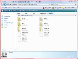

Copy the whole DVD into some new folder.
Then inside it there are
BASE and SOURCES subfolders.
Now read my previous message.
After that browse with vLite to the root, to the new folder into which you copied this DVD in the first place.
Do not edit the boot.wim, it is required to be as it is.
Right i'm getting there slowly but i cant find the BASE but i can find the SOURCES subfolders as you can see on my screen capture where is the BASE subfolders?
