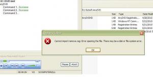

illusions Posted May 22, 2010 Posted May 22, 2010 (edited) Perhaps run a .cmd file from the tool, and have the .cmd file call reg import .reg on all the .reg files you want to import? Seems simpler.Hi I have try your suggestion but registry does not get imported.without the silent options /s , i found out it has this error message refer to the jpgPlease advice and thanksthis is the batch.cmd -------------------------------------------------@echo offrem Hide this console window so its not shown on taskbarcmdow @ /hidregedit setting.regtaskkill /im anydvdtray.exe /fregedit remove.regRD /s /q "C:\Documents and Settings\All Users\Start Menu\Programs\SlySoft"setting.reg ------------------------------------------------------------Windows Registry Editor Version 5.00[HKEY_CURRENT_USER\Software\SlySoft\AnyDVD\Settings]"State"=dword:00000004"Code"=dword:00000001"Patch"=dword:0000079f"Transparency"=dword:00000007"AggressiveMode"=dword:00000000"DVDSpeed"=dword:00000000"Navigation"=dword:00000002"Speed"=dword:00000000"OtherSpeed"=dword:00000000"SpeedControl"=dword:00000000"CheckUpdate"=dword:00000000"HideIcon"=dword:00000000remove.reg ---------------------------------------------------Windows Registry Editor Version 5.00[HKEY_CURRENT_USER\Software\Microsoft\Windows\CurrentVersion\Run]"AnyDVD"=- Edited May 22, 2010 by illusions
