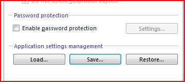

oskingen Posted February 24, 2008 Posted February 24, 2008 (edited) To get the msi, just extract it from the .exe or launch it and pick it up from %temp% folder of if already installed from your ProgramData\kaspersky\setup folderKis/KAV 7 and version TR 8We can use this command line to install KIS/KAV 7 silently :start /wait Kaspersky\kis.en.msi /qb /norestart. but no way to remove some componentKIS/KAV 6We can use this command line to install KIS/KAV 6 silently :start /wait Kaspersky\kis.en.msi /qb /norestartCreate a setup.ini file in the same folder of Kaspersky with the following. (1= install / 0=Don't install)Setup]Reboot=noSelfProtection=no[Components]FileMonitor=1MailMonitor=1WebMonitor=1ProactiveDefence=1AntiSpy=1AntiHacker=1AntiSpam=0for both versions If you put the key in the same folder it will automatically add it. You can also add your config file. Before upgrade just save your config file from the Service tab in Kaspersky to install.cfg. During next install your antivirus will be automatically configured with your previous setting. Edited May 14, 2008 by hannubys

oskingen Posted May 17, 2008 Author Posted May 17, 2008 You can save your config file from the Applications Setting Management. The config File 'install.cfg' is working with versions 6, 7 but not 8 at least not yet.About the setup.ini i did not figure out about Control Parental. I tried a lot of variable but i couldn't get Control Parental feature removed.Now I'll focus on 8 versions.
