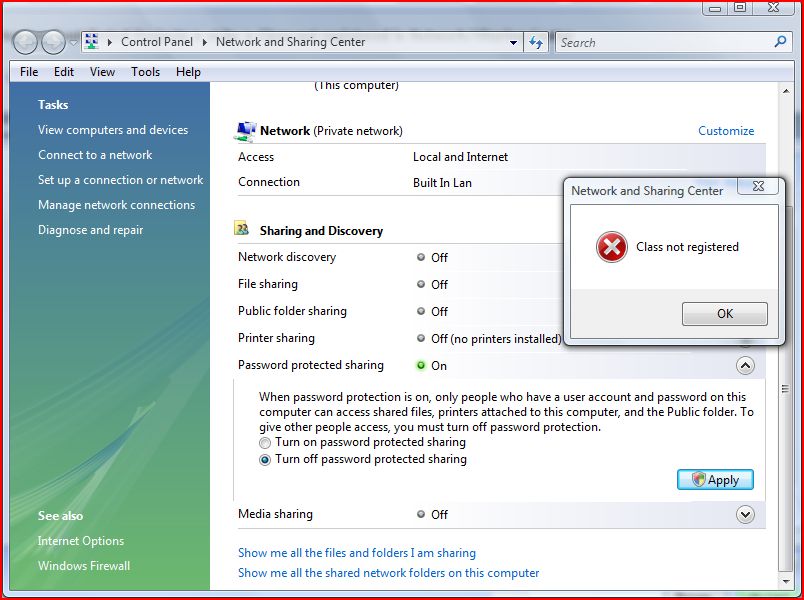

I am having the same problem.
my vlite config file is attached and i have verified that bith the Network List Server and Network Location Awareness services exist and are turned on.
here is a picture... i want to turn off password protected sharing sharing, but when i try to i get the class not registered error.
Last_Session.ini
I think it could be "File and printer sharing (Server)".
Edited by Dynaletik
