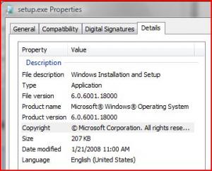

jaws75 Posted February 9, 2008 Posted February 9, 2008 (edited) In a preintegrated disc from MS all the setup files are version 6.0.6001.1800. In a reverse integrated disc the setup files will be 6.0.6000.16386. Only the install.wim file is updated to sp1.preintegrated is better.the setup is a little different with a different image available to set as the background. Edited February 9, 2008 by jaws75

jaws75 Posted February 10, 2008 Posted February 10, 2008 (edited) jaws75, my reverse integrated has the proper SP1 version listed. vLite reads that from the install.wim.You misunderstood what I meant nuhi.All the install files on the DVD like setup.exe and all the .dll files have been updated by MS. In a reverse integrated disc only the install.wim is updated. All the rest of the install files will still be original RTM.setup.exe from a MS sp1 disc (x64). ( I also have x86 sp1 and they are updated too). Edited February 10, 2008 by jaws75
nuhi Posted February 11, 2008 Posted February 11, 2008 Oh that, ok thx for the explanation, that's true.But if you don't have any issues with the setup process it is all the same, what's important is in the install.wim, setup files don't get used after install.
