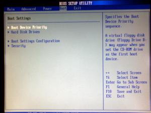

mara- Posted January 25, 2008 Posted January 25, 2008 I have ASUS P5LD2-X/1333 and here are some screen shot's:Here I choose Hard Drives:And then as 1st drive I select my SATA disk and Windows will assign it letter C:\ on the installation of Windows.Cheers

jcarle Posted January 26, 2008 Posted January 26, 2008 I have ASUS P5LD2-X/1333 and here are some screen shot's:Here I choose Hard Drives:And then as 1st drive I select my SATA disk and Windows will assign it letter C:\ on the installation of Windows.Cheers Um... okay, you've proved to me that I was right. There are NO BIOS OPTIONS TO CONTROL THE CONTROLLER DETECTION ORDER. You have it very clearly in your screenshot in big bold white letters, it is the BOOT DEVICE PRIORITY, it does NOT control the order in which Windows will detect controllers. This is very apparent on older motherboards where the SATA controller was an on-board chip and not part of the southbridge where as modern motherboards have it the other way around, SATA in the southbridge and IDE on on-board chips.

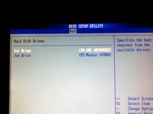

mara- Posted January 26, 2008 Posted January 26, 2008 No, no, I just selected wrong on picture. I choose option under that, the option "Hard Disk Drives". Maybe you are right about detection, but when I choose here as first drive my IDE disk, Windows Setup will assign C:\ to it, and when I select as first drive my SATA disk, Windows Setup will assign C:\ to SATA.Cheers
