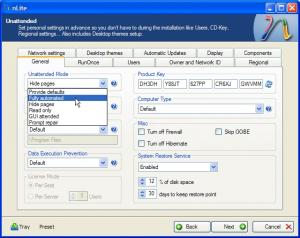

mara- Posted November 6, 2007 Posted November 6, 2007 (edited) You need to select Fully Automated on General page.Cheers Edited November 6, 2007 by mara-

Fernando 1 Posted November 7, 2007 Posted November 7, 2007 (edited) You need to select Fully Automated on General page.mara, you should remove the picture or replace it by another one, because everyone can read the CD key of your OS.CUFernando Edited November 7, 2007 by Fernando 1
