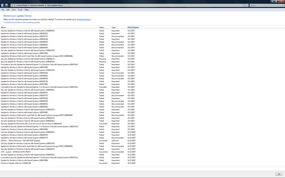

manda Posted September 2, 2007 Posted September 2, 2007 I used vlite 1.1 beta to remove all I wanted and now i cant get a single update installed, they all fail.Also used the reg patch release to see if it would help and had no luck.PS: Vista Ultimate 64 with patches till august. Any solution?

manda Posted September 3, 2007 Author Posted September 3, 2007 (edited) I removed a lot stuff, including the things on the main page news, pretty much everything i thought it was useless, and after that i didn't disable anything else.I attached my presets so maybe you guys can have a good idea of whats the problem, and one thing I noticed is when I used vLite on a Vista with August updates it wouldn't install, I had to use it on a July image.Rafael.ini Edited September 4, 2007 by nuhi

manda Posted September 7, 2007 Author Posted September 7, 2007 Are you saying that those failed ones are actually integrated, they didn't fail after the install?edit: check thishttp://www.msfn.org/board/index.php?s=&...st&p=686994fixed in next version.Nope, those are new updates that I got from Windows Update, the image I used was had all the updates integrated until July, and those on the SS are new ones.
Legolash2o Posted September 7, 2007 Posted September 7, 2007 (edited) ok, thats odd... mines doing the same thing EDIT: doesn't matter nowOK, before you actually click install on the updates, goto "View available updates" and untick "Update for Windows Vista for x64-based Systems (KB932596)" and install the rest of the updates. You won't be able to install the update above so its easier if you right clicked on it and select hide. Edited September 7, 2007 by legolash2o
manda Posted September 21, 2007 Author Posted September 21, 2007 ok, thats odd... mines doing the same thing EDIT: doesn't matter nowOK, before you actually click install on the updates, goto "View available updates" and untick "Update for Windows Vista for x64-based Systems (KB932596)" and install the rest of the updates. You won't be able to install the update above so its easier if you right clicked on it and select hide.I had to change my power supply but now I tried to do the updated unpicking what you said and it worked fine.Thx Guys
