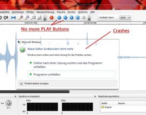

Using Nero Lite 8.1.1.0 with Vista Ultimate x86. What I really need a lot is the Nero Wave Editor, but since I use the Lite versions I do have a lot of problems with it.
eg after editing a mp3 file I'm still able to save it, but then Wave Editor just crashes. I can also play songs only once in the Wave Editor and then the 'Pause' button won't change back to 'Play'....
If there's any further information I could give you to solve the problem (I'm not sure if there is some kind of log), please let me know.
The Playbutton thing is not that bad for me, but the constant crashes make working with the Editor very unpleasant.

Ok, I just upgraded to Nero Lite 8.2.8.0 and have exactly the same issue...
I included a screenshot to show the problem
Am I the only one having this bug?
This happens after playing a file, the Play buttons are there when I start the Editor and then just stay as the 'Pause' icon + the crash, of course
Still any help appreciated, Chris
