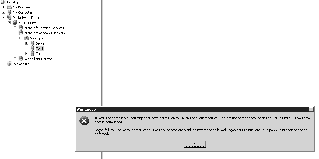

But preSP2 WinXP or any Win2k or Win2k3 SERVER dont have this issue with blank passwords! Apperantly MS had to protect its consumer windows
U just gave me the idea! Since I have a passwordless login WinXP SP2 automaticly denies all access to drives. And thus I had to change GPEDIT.MSC LIMIT LOCAL ACCOUNT USE OF BLANK PASSWORDS TO CONSOLE ONLY to FALSE and now it works

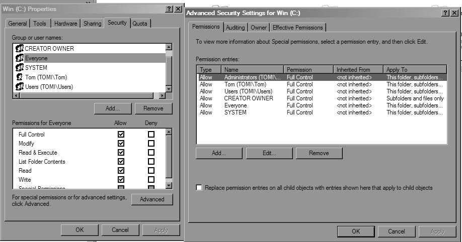

I ADMIN the LAN for my famil:) And its only 3computers + Win2k3 server Here's a screenie of my settings:
When trying to access the computer WinXP SP2 called TOMI from another computer in our LAN I get the following error: And this is how the share on the computer called TOMI is set up: What am I doing wrong, since I've done this thousands of time and it always worked. What is wrong now?
