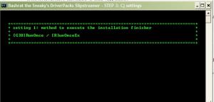

I have but it did not do anything. It just shut the screen and did not give me any other option to continue. Maybe that's the way it is? I am a newbie but not that bad
Sorry for keep posting but I need help
I hope I get this answered soon since that screen (the attached picture) is still waiting for me to do something
I don't know what to do it after this screen. How do I choose Guirunonce or the other one? After choosing I am done, correct? Also while decompressing, ipgnd51.sys could not be found but other than that it looked like everything went fine. I am a newbie so please help Thanks!

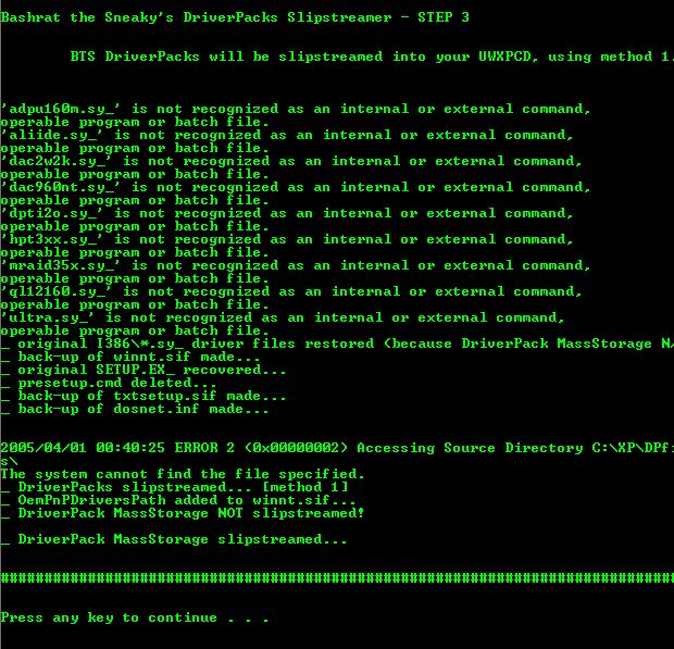

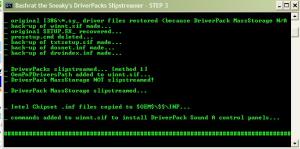

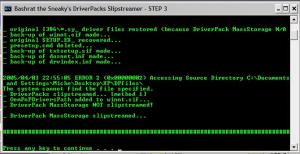

I knew I was doing something wrong How does it look now? Looks fine but one thing confuses me; it says MassStorage is not slipstreamed then below it says it is. Still good? Ooo one more thing, I am going to burn this to a DVD? My XP folder is 944MB after the slipstream. Can I delete some folders/files like support, etc?

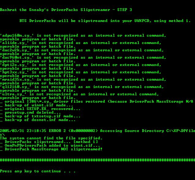

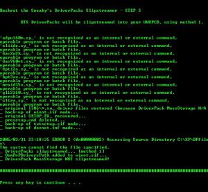

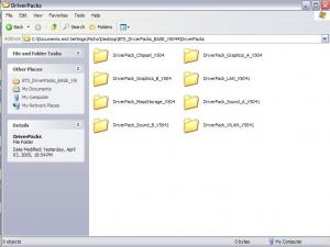

I am going to write everything step by step. First I downloaded the new base 5041. Then I put the driver packs (5040) in the "driverpack" folder. Then I run BTS_DPs_Slipstreamer_V5041 chose method 1 and put the contents (M1 and Run_Me.cmd) of UWXPCD_Root to my C:/XP which I copied all from my SP2 slipstreamed XP CD. Then the errors which I posted the screenshots in this topic. I have no idea why I am having this problem. I am using XP SP2 English.

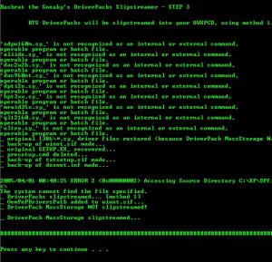

Ohh boy I am getting the same error except the massStorage is slipstreamed even I edited the old Run_Me.cmd and downloaded the new base

So, what do I do know Well, I edited the RUN ME.cmd and will try now Let's see what happens.

I downloaded all the driver packs and put them in the "Driverpacks" folder. Then I copied the contents of "UWXPCD_Root" to the root of my XP folder which I copied all the contents from the XP CD and copied to XP folder which I created under C:\. So, this is what I did. Copied the folder "M1" and Run_Me to my C:\XP\I386 Ran the "Run_Me" and then I am getting some errors like the MassStorage not slipstreamed, etc. Am I doing something wrong?
