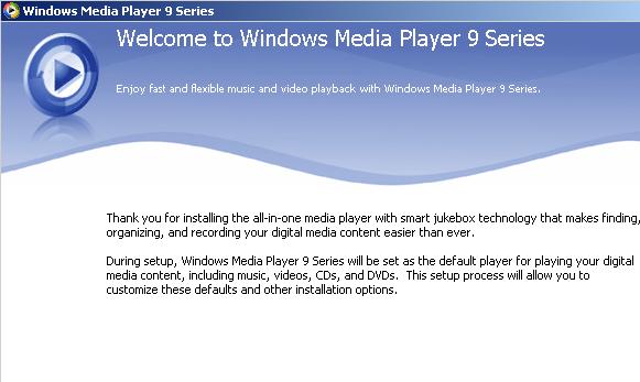

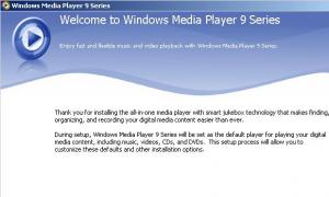

I got WMP9 to install unattended right. The problem is I need to get rid of that setup screen that appears after you first run it. That screen appears for every new user that runs WMP, is there a way to have it not appear and just run WMP with defaults?
