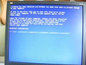

  8. ·
    Edited by peter777
    Thanks for your replies. I do notice when it tries to boot in XP, that there is a (very quick) blue screen, but I can't pause it to see what is written there. I will try the F8 to disable auto reboot. I can actually view the entire drive from Kubuntu. Here is boot.ini
    [boot loader]
    timeout=30
    default=multi(0)disk(0)rdisk(0)partition(1)\WINDOWS
    [operating systems]
    multi(0)disk(0)rdisk(0)partition(1)\WINDOWS="Microsoft Windows XP Professional" /noexecute=optin /fastdetect
    Sorry for not giving more details. The PC that I used that HDD in for XP Pro was a asus p2-350. It had less ram and an old video card. The drive is a 250Gb sata seagate. I had used the same display/monitor through a KVM switch. The software was purchased probably about 10 years ago. I still have that CD with the COA on it.
    The new computer (well 6 yrs old) is an asus also. If I could stop the display at boot and record that info, it may help. If possible, I don't want to have to reinstall XP pro, as I also have some old win95B software on it that I use from time to time.
    I have managed to take a video of the startup and freeze that frame.
    post-365135-0-84168200-1422833046_thumb.
