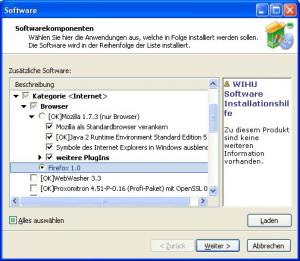

Ah, okay, I see! So thanks for ya answer! Most important is that in the case shown above Mozilla as well as its sub entries don't get installed. And you approved this. So I'd say this is less a bug than a cosmetic issue.

Hi! Maybe I found a bug, at least it strikes me as one. *hehe* I enclosed an attachement ... let me explain it using the picture: 1.) I click on "Mozilla 1.7.3" --> everything else below gets selected, too. Great! 2.) Then I click on "FireFox 1.0" --> "Mozilla 1.7.3" gets deselected what is fine, too! But ... what doesn't get deselected are the sub entries of "Mozilla 1.7.3" (this is shown in the screen shot) although they should get deselected, right?!?
