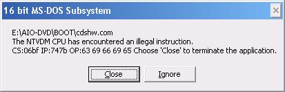

Problem solved, I've used the wrong cdshell. About my second question, found out myself too. These are required to start the installation, if missing you get a message like "Please insert the disk labeled Windows Professional SP2" Thanks to those who replied for your help

According to flyakite's Multiple boot vd/dvd guide I should be able to debug cdshell. When I open cdshw.com in my BOOT folder I get the following error message (see attachment). I already tried to copy autoexec.nt and config.nt from the Windows\Repair folder to System32 but the problem remains. Does anyone have any idea how to solve this. Just a quick second question while i'm here. Can someone explain me why WIN51, WIN51IP and WIN51IP.SP2 should be in the AIO-DVD folder cause this is confusing me. Thanks in advance.
