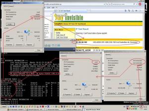

  22. Don't you just love the things you can do with your network? Here's the latest thing I've tried on Server 2008: Please notice the abnormalities in this picture
