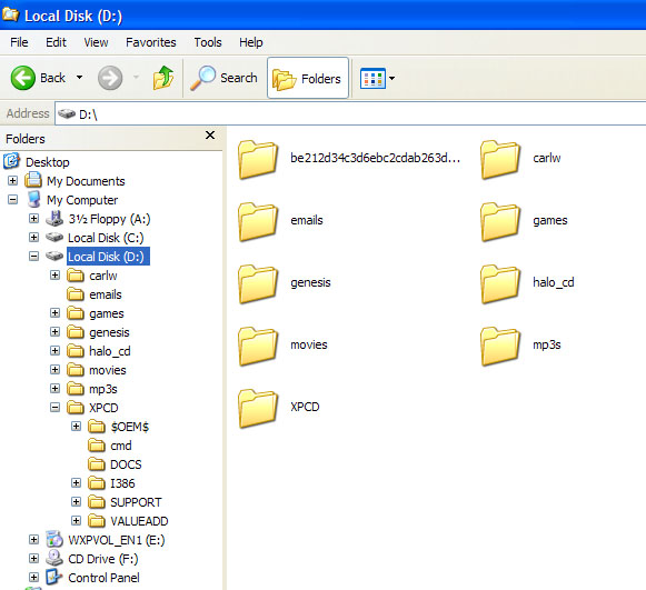

neophyte Posted October 9, 2003 Author Posted October 9, 2003 Check the screenshot here. In it you can see a folder with a textstring of random alphanumeric characters.These folders simply won't delete, and I can't find any switch that supresses the creation of them.This is starting to really p*** me off.

Klaassh Posted October 9, 2003 Posted October 9, 2003 Run an update (without switches) manually, now leave the window open without pressing next and somewhere on your system you should have one of these folders.I can do this and on pressing cancel the folder disappears. but not so on my install cd the folders do not delete. It's not a big deal for me, as I can delete it manually after but I can see where neophyte would be frustrated, not being able to delete these folders.Neophyte, do you disable sfc? perhaps try this, disabling it to delete them and if sfc is a feature you use, reenable it afterwards.Still not a fix though
neophyte Posted October 9, 2003 Author Posted October 9, 2003 AaronXP: Seems your not the only one that is puzzled by them.I have asked several other people if they get them, and they do not, yet some do.What really irritates me, is that when I used a cmd file to install the updates, the folders would generally remove themselves after a reboot, but whilst using the SVCPACK.INF method, they don't.The only files generally left in the folders are the update folders and xpsp1htm.exe file.If I can't figure out why this is happening, and/or how to stop it, I'll have to go back to using the .cmd installation method, which I'm not to fond of.Or I'll just stick to leaving XP + SP1 on it.
