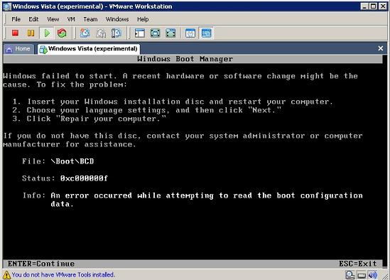

vim Posted January 18, 2007 Share Posted January 18, 2007 cassius2117, right.I'm then waiting for a confirmation.Here it is. It failed using VMware. See attachment. Link to comment Share on other sites More sharing options...
nuhi Posted January 18, 2007 Share Posted January 18, 2007 vim, excellent!Now just some more of your patience and it will get fixed.Go in command line, focus on the source root folder, for example D:\VistaDVDfrom which you made that failing ISO.And typedir /s /b>list.txtthen compress and attach or send me on email the list.edit: file list received and bug confirmed. will be fixed in the next version. Link to comment Share on other sites More sharing options...
