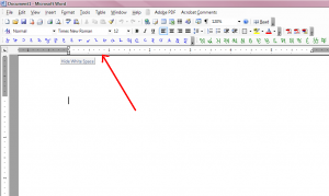

spacesurfer Posted January 10, 2007 Posted January 10, 2007 Actually, you're margins are fine. What I think you've done is you've hidden the white space between the pages. See the attached image.What you have to do to get that white space is click in the small gray area below the ruler and right above the page. You'll see a prompt that says either "Hide White Space" or "Show White Space". Click and you're done.
hiwaytravel Posted January 10, 2007 Author Posted January 10, 2007 THANK YOU THANK YOU! You are a GOD of MS Word!
