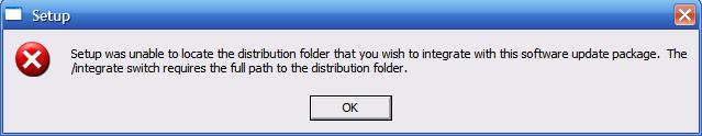

XL-DJK Posted October 2, 2006 Posted October 2, 2006 (edited) Run... C:\HOTME\KB896401.exe /integrate:C:\XPCD\i386 any hotfix I try to integrate, gives me this darn errorWhat the heck do I do? Edited October 2, 2006 by XL-DJK95355
Mercury_22 Posted October 2, 2006 Posted October 2, 2006 Run... C:\HOTME\KB896401.exe /integrate:C:\XPCD
XL-DJK Posted October 2, 2006 Author Posted October 2, 2006 (edited) I even tried that, and it STILL won't work Here's a basic breakdown of my CD and it's location. p.s. the hotfix no. I used on my previous post is made up...doesn't work with any of the 71 hotfixes I'm trying to apply.what the heck is going on? RUNNING WindowsXP VRMPOEM_EN SP2C:\XPCDC:\XPCD\I386 Edited October 2, 2006 by XL-DJK95355
XL-DJK Posted October 2, 2006 Author Posted October 2, 2006 To add to this, here's some of the hotfixes I'm applying to my CD Copy:The /integrate procedure isn't working on these one's either:KB873333 KB885835 KB885836 KB886185 KB887472 KB888302 KB890046 KB890859KB891781 KB893756 KB894391 KB896344 KB896358 KB896423 KB896424 KB896428KB898461 KB899587 KB899589 KB899591 KB900485 KB900725 KB900930 KB901017KB901214 KB902400 KB904706 KB904942 KB905414 KB905749 KB908519 KB908531etc... etc...

XL-DJK Posted October 4, 2006 Author Posted October 4, 2006 sweet....thanks, it turned out the CD Copy I had was corrupted....<shrugs>...and when I extracted the folders from the corrupted CD Image, files were missing or unreadable
