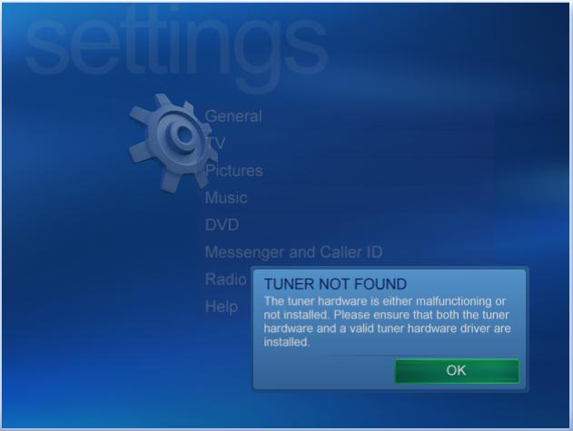

XL-DJK Posted September 29, 2006 Posted September 29, 2006 (edited) Can anyone PLEASE help me out with this? as MCE2005 says the following: TV2000XP Expert Edition TV/FM Tuner comes with WDM Drivers but still it won't recognize thru MCE2005....WHY?!??! WHY?!?! Edited September 29, 2006 by XL-DJK95355
boooggy Posted October 1, 2006 Posted October 1, 2006 very simple why....cause it is not supported by mce.... http://www.leadtek.com.tw/eng/tv_tuner/def...amp;seriesid=56
XL-DJK Posted October 1, 2006 Author Posted October 1, 2006 That was an ingenius answer ....do you think it could be possible to either create bda drivers for this tv tuner or even possibly "trick" mce into using the tuner card?

dougiefresh Posted September 4, 2007 Posted September 4, 2007 My tuner card also said Media Center compatible. Installing Media Center w/o the updates results in same screen you got. Updating to the Update Rollup 2 seemed to solve the problem.... Hope this helps!
