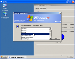

Not really.. PE running on 31Mb can also shutdown completely, just use explorer as shell along with "ShutDownRes.dll" - it will allow you to completely shut down the machine.
Take the screenshot as an example of this:
It is added as a feature inside explorer.script, so it's just a matter of applying it on your WinPE without needing to manually edit any files and using your already existent PE build.
Hope this helps! :)
Actually explorer.script is using my shutdown utilitities. They are downloadable from www.paraglidernc.com and will work without explorer. The replacement msgina.dll ( pegina.dll ) is also needed as well. shutdownres.dll just contains english string resources used by pegina.dll.
If you are not using explorer then the explorer shutdown gui can be invoked by calling shutdown.exe with the /g parameter. Its all described in the Usage link for the utilities. Note that the original msgina should be named ginaorg.dll and pegina.dll should be named msgina.dll.
