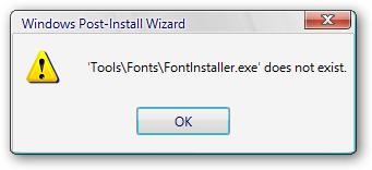

parkerkane Posted September 14, 2006 Posted September 14, 2006 (edited) I moved over my useroptions.js and my config.js but when I try to start WPI I am getting this error (file should be attached) I checked and the file is there. Help?EDIT: It's probably something simple but I have no idea where to look. Edited September 14, 2006 by parkerkane

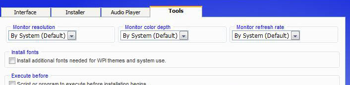

parkerkane Posted September 14, 2006 Author Posted September 14, 2006 With a completely clean extraction of the rar file (none of my files or settings), if I check the box "Install additional fonts needed for WPI Themes and system use" I get the error in the pic in my first post. Anyone have any ideas?
zorphnog Posted September 14, 2006 Posted September 14, 2006 This was mentioned in the release thread. Kelsenellenelvian and others are trying to find a solution.http://www.msfn.org/board/index.php?s=&...st&p=560096
