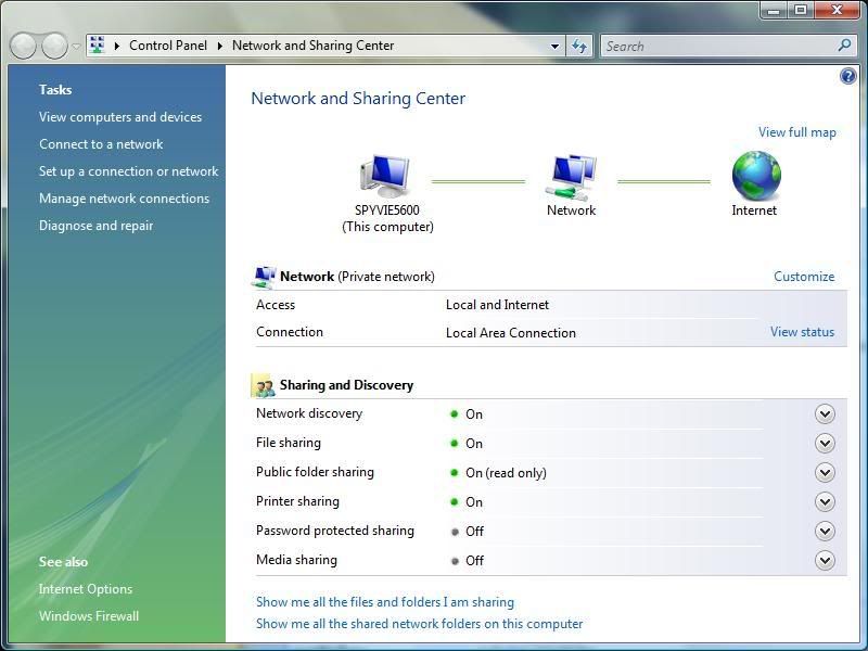

In the Network Center there is a place to turn off the password requirement.
Just open the start menu and type "network center" You'll then see it on the list. The option to adjust the password settings is on that screen. After he said that, that's all I did to find it. Took a few seconds to find out I was wrong about password settings. :)

When i type "network center" i only get "network and sharing center" .. nothing to change password on the list
Just make sure "Password protected sharing" is set to off, like in this example...
