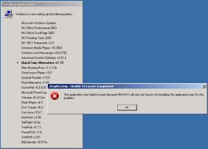

Nucleus Posted August 4, 2006 Share Posted August 4, 2006 To install QuickTime Alternative v1.72 I use this:REG ADD %KEY%\009 /VE /D "QuickTime Alternative v1.72" /fREG ADD %KEY%\009 /V 1 /D "%CDROM%\Software\QuickTime\QuickTime.exe /VERYSILENT" /fDuring unattended installation I get this error message:This application has failed to start because MSVCR71.dll was not found. Re-installing the application may fix this.When the unattended setup finishes, I uninstall and re-install QuickTime Alternative v1.72 and the message does not appear again.Any ideas what's causing this? Link to comment Share on other sites More sharing options...
Camarade_Tux Posted August 4, 2006 Share Posted August 4, 2006 Try to install QTAlt later : it's likely and app that you install updates msvcrt71.dll (Acrobat for example). Link to comment Share on other sites More sharing options...

Sphinx-cn Posted August 5, 2006 Share Posted August 5, 2006 or if you use the $OEM$ folders, just find (through google) MSVCP71.DLL and msvcr71.dll and put them in $OEM$\$$\system32that works for me Link to comment Share on other sites More sharing options...
Nucleus Posted August 8, 2006 Author Share Posted August 8, 2006 (edited) It seems that a lot of previously installed software are using that DLL file.PowerDVDNero Burning RomAdvanced System Optimizer. Edited August 8, 2006 by Nucleus Link to comment Share on other sites More sharing options...
Camarade_Tux Posted August 8, 2006 Share Posted August 8, 2006 Nero and PowerDVD are installed later. At the end of installation, do you have a msvcrt71.dll file on your computer ? If you do, just move QTAlt at the end. If not, you'll have to put it there.Also, an app that use a dll may not complain during installation. Link to comment Share on other sites More sharing options...

Nucleus Posted August 10, 2006 Author Share Posted August 10, 2006 I tested version 1.73 and it's OK Link to comment Share on other sites More sharing options...

MGadAllah Posted September 2, 2006 Share Posted September 2, 2006 Download latest version QuickTime Alternative 1.75 and it does not has this problem. Link to comment Share on other sites More sharing options...
