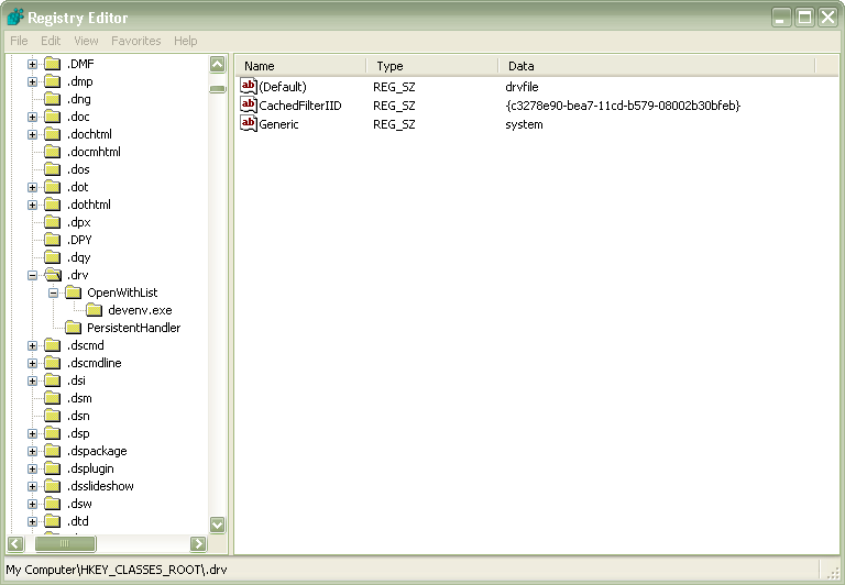

LLXX Posted June 13, 2006 Posted June 13, 2006 Start regedit and go to the classes_root, find Drive and expand it, select Shell subkey and then select the Default value on the right, press Delete key.
Mamoun Posted June 13, 2006 Author Posted June 13, 2006 (edited) Thanks for replying,@T D: There is sth wrong with the link, It's a link to site that sells domain.@LLXX: Do you mean drv file type? Okay I expanded it, and here what I saw:There is no sub key called shell, so what to modify here?and looks like that Drive has no extension Edited June 13, 2006 by Mamoun
T D Posted June 13, 2006 Posted June 13, 2006 (edited) Aaargh! I missed out a hyphen!http://www.tune-up.comI'd still recommend it even if you don't have problems.You picked the wrong key."Drive" not ".drv"!Screenshot: Edited June 13, 2006 by T D
Mamoun Posted June 13, 2006 Author Posted June 13, 2006 (edited) Thanks again TD, I will take a look at tune up.And at last I found it, deleted the modified key, but it didn't work, then I tried to change it to "none", and it worked!Thanks guys for your assistance... Edited June 13, 2006 by Mamoun
