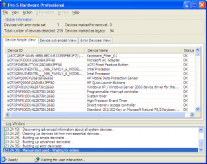

What is it for:
This program was written to help install drivers on newly installed computers. It's main goal is to be used after Windows is installed and after user logs in for the first time to Windows using Administrative account. All you do is put drivers for all (or just one) computers in one directory, start the program and press Action/Install Missing Drivers (or in Automatic mode just start program and it should do all steps by itself). It should remove unknown devices from system and recheck them with drivers you have uploaded to drivers directory of your choice. If it finds the drivers, device gets installed without any questions. Usually drivers should work in the form that they are supplied by manufacturer, but sometimes it may require some work from your side to prepare them.
To run program you need:
1. pro-s_hardware_<version>.exe
2. hardware_config.xml
This program is fully functional with Driver Packs. Newest version and config file can be found at projects website.

About section: This sections is the most important section of this program. This is where you define how program should behave when trying to find and install drivers.
==> <drivers_method>New</drivers_method> -> Possible settings are Old and New.
[*] Old drivers method is simple and takes all directories that have files (.inf) inside and puts them either in registry (when using method RegistryDevicePath) or integrates each inf separatly to system directory (when using SetupCopyOemInf method).
[*] New drivers method is a bit more advanced. It goes thru all files (.inf) and finds Hardware ID's they support. Then program compares them with devices that require drivers to be installed (so called Error Devices) and if any drivers match then that specific driver directory is added to registry (when using method RegistryDevicePath) or integrates that inf separatly to system directory (when using SetupCopyOemInf method).
==> <drivers_database_use>Yes</drivers_database_use> -> Possible settings are Yes or No.
[*] Comment: Worth to notice information is that if you use New Drivers method you don't nessecary need to set this on. Program will internally create database of drivers anyway. However creating database of drivers overhead can heavily increase speed of finding and installing correct drivers.
==> <drivers_database_recreate>No</drivers_database_recreate> -> Possible settings are Yes or No.
[*] Comment: Not realy useful feature as it will try to create new database every time program runs. As this is time consuming it would be the same as settings <drivers_database_use> to No when using New drivers method. You may wish to skip this or simply experience this for yourself.
==> <drivers_database_path>$ProgramDir\hardware_database.db</drivers_database_path> -> Full path to drivers database. Can use variables\mapped drives as described below.
[*] Comment: This setting is important for <drivers_database_use>. If you set <drivers_database_use> to Yes and your path to this database will be incorrect program will automatically turn of <drivers_database_use>.
==> <drivers_directory_path>RELATIVE:\PenDrive\Drivers</drivers_directory_path> -> Full path to where drivers are located. Can use variables\mapped drives as described below.
==> <drivers_packed>Yes</drivers_packed> -> Possible settings are Yes or No.
[*] Comment: Both .7zip and .rar format are supported. Note this may or may not work with <drivers_database_use>. But in my opinion to get this to work you would have to unpack .7z files first, run database prepare on it and then use packed files (which would be unpacked on program run). Feel free to use Bashrat Drivers Pack with this.
==> <drivers_copy>No</drivers_copy> -> Possible settings are Yes or No.
[*] Comment: This is to be used when you want to copy drivers first to some drive before "playing" with them. Works in conjuction with <drivers_copy_path>
==> <drivers_copy_path>C:\DriversTest</drivers_copy_path> -> Full path to where drivers are to be copied. Can use variables\mapped drives as described below.
==> <drivers_copy_delete>No</drivers_copy_delete> -> Possible settings are Yes or No. This setting should be used when we want drivers to be deleted when quiting the program.

The use of program is standard mode:
1. Set the right stuff in hardware.xml (drivers location, can have subdirs etc).
2. Start the program. Removal of Unknown devices should start (in Automatic start or requires a button in Manual start)
3. Redetection of removed devices should start.
4. After windows finishes installing drivers you should be told so. You can then safely click the Exit button.
NOTE: In Automatic version program will close itself when done.
