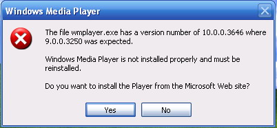

but with wmplayer10 doesn't work. It get installed but when the windows xp is installed and when you open Windows Media Player it asks for the introductory Next Next... and After Finish the attached error is generated and doesn't work.
@ ashrafzia
This message is not related to the SFX.
