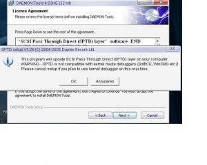

MHz Posted January 5, 2006 Posted January 5, 2006 403 scrip doesnt work .. it hangs during setupFrom my 4.00 AutoIt (which MHZ have write too) experience, it looks like hung but after 30 seconds (???) it go further... i guess it is the same as 4.03 I seen a hang of up to about 5 seconds, but 30 is abit much. Too save too many messages being sent to window which may confuse it, I have added some timed WinWaits. This means the window hung, will not receive another click for up to 15 seconds. This should indeed help your issue.4.00 doesnt hang at my end , only 403I would expect the installers to behave the same and my tests show same behaviour. Thanks for the posted picture. I see annuleren on a button but hopefully the ClassnameNN's used should manage the language difference OK.Oh, bujo696, a good edit of the script. To AutoIt Thread

MHz Posted January 6, 2006 Posted January 6, 2006 (edited) Well, I consider that installing this SPTD from Cmdlines.txt will make installation smoother. Anyone up to test?Instructions:When you go through installation of DT4, the SPTD messagebox pops up. Just copy the SPTDinst.exe from the temp directory and place it in the same directory as Cmdlines.txt. Cancel the install, if wish. Then add the following script next to Cmdlines.txt for execution at T12._SPTDinst.htmlNow that SPTD is installed, at T0, the OS will reboot into RunOnceEx and will execute the following script which will install DT4. That should be it, nothing further to do._Daemon_Tools_v4.03.htmlSPTDinst.exe is an extra 800 kb to your UA, but it could be worth it. DT4 will install completely, 1st time.Should be no 2nd reboot for DT4 after the RunOnceEx install. Edit: small script change. Edited January 6, 2006 by MHz
