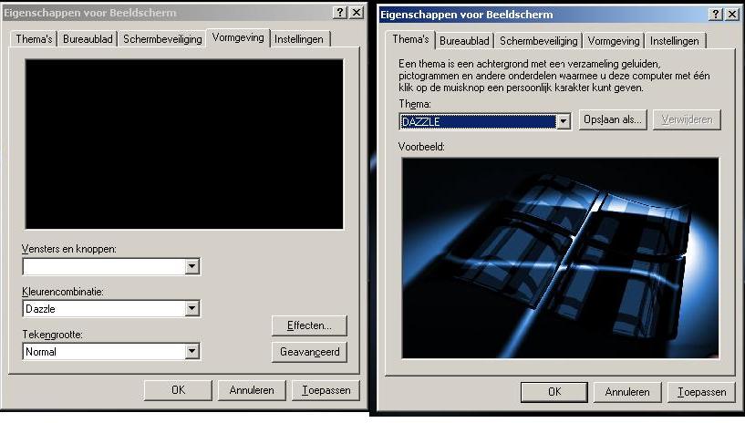

MADIKKE Posted November 4, 2005 Author Posted November 4, 2005 Well I figured it out how to install my theme, the boot-thingy didnt work yet though...Only One thing with the themes....They don't work properlyThe icons and the background ARE changed, but the interface (As you can see on the screenshots) isn'tHelp ?
Kelsenellenelvian Posted November 4, 2005 Posted November 4, 2005 Did you use a patched uxtheme.dll? It is a MUST if you want themes.
MADIKKE Posted November 7, 2005 Author Posted November 7, 2005 Well yea, I believe so, I got it somewhere from here....Or could anyone post 1 to another patched version ???Don't know if it nessicarily(orsomethin) but im on WinxpProSP2
Kelsenellenelvian Posted November 7, 2005 Posted November 7, 2005 http://www.lucifiar.net/download/nw_uxpatcher.zip
suryad Posted November 7, 2005 Posted November 7, 2005 Well from your screenshots it looks like your theme service could be turned of......maybe that is why they are not showing up properly?
MADIKKE Posted November 7, 2005 Author Posted November 7, 2005 Tnx kelsenellenelvian, that worked ! Now how to make it unattended ?? @ Suryad, themes are enabled in the service menu
SiMoNsAyS Posted November 7, 2005 Posted November 7, 2005 nlite can patch the uxtheme.dll file and enable the themes service. is that what you were looking for?
MADIKKE Posted November 8, 2005 Author Posted November 8, 2005 I got that fixed by now, I just put the patched uxtheme.dll in my I386 dir so it get's copy-ed And it works !! Now for my boot menu...
