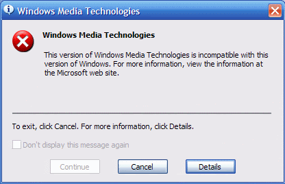

here is a screenshot of the error:
it turns out that wmp setup is not throwing this error, but windows is. i guess there is a component in xp called "Application Compatibility User Interface" that will not allow you to install certain versions of certain programs that it recognizes to be incompatible.
i searched on google, and i was able to disable this compatibility checking by renaming c:\windows\system32\ahui.exe before running the setup. then wmp9 installed successfully! (build 2980)
