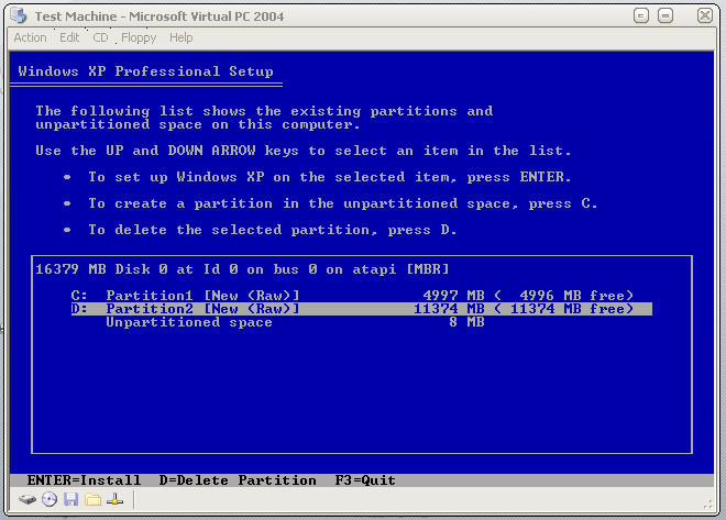

Iki Posted August 12, 2005 Author Posted August 12, 2005 Hmmmm, well i create the partitions (see image)... But find no option at all to format the 2nd partition? I can only delete it or install windows to it, not format it
spider2005 Posted August 14, 2005 Posted August 14, 2005 Hmmmm, well i create the partitions (see image)... But find no option at all to format the 2nd partition? I can only delete it or install windows to it, not format it <{POST_SNAPBACK}>i've been trying to do the excat same thing but since partition2 isn't formatted i can only install everything into 1 the boot into windows create part 2 and then reinstall which is bit of a paini'd really like to know a sl for this would using 3rd party progs help?
