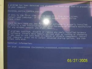

post-91543-1144807740_thumb.jpg :thumbdown After looking through the forums for a little over a month now I finally decided to jump in here. I have a Supermicro AW4020c-t server with the H8DCE mb. I have been trying for a little over 6 weeks to get a raid 1 configured. I have tried nLite and a couple others without any luck. It blue screens right after the textmode just as it goes to the GUI install. If I disable the raid it installs but the cdrom starts giving read errors and won't load any drivers. I sent the board back once and when I got it back the same old thing. Supermicro said to box up the whole system and they will take a look at it . The system has 2 Opteron 246 cpu's - 4 gigs of samsung ddr400 memory - 4 hitachi sataII 160gb hdd - sony dvd+-wr and a 128mb geforce 5700 video card. Any suggestions before I crate it up?? BTW the raid rom is v4.81.
Any help is appreciated
TonyC
  • Author
I have tried nLite and a couple others without any luck. It blue screens right after the textmode just as it goes to the GUI install. If I disable the raid it installs but the cdrom starts giving read errors and won't load any drivers. Any suggestions before I crate it up?? BTW the raid rom is v4.81.

Got the BSOD right as the Windows logo loading screen came up, just as before.
Did you try to boot in safe mode (by hitting F8)?
I can't boot into safe mode if Windows isn't installed. The BSOD comes right after all the drivers and files are copie, then it auto-restarts. Its half-way through the installation.
  • Author
Got the BSOD right as the Windows logo loading screen came up, just as before. I am going to try the Legacy only method this time through.
Sorry, I misunderstood your first post.
If the installation fails at the beginning of the GUIMODE part, you probably have a hardware and not an nForce SataRaid driver problem.
You can verify this by trying to install XP via F6/floppy and using the nForce SataRaid drivers off the 6.53 package.
Have you put off all unnecessary devices?
No overclocking?
All cables ok?
