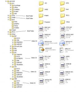

can you add a picture like so??
but based off of what you are saying... i think either you boot folder is to blame, or you boot "datt" file is the problem....

i wanna add a screenshot of my folder structure, but i just know how to integrate images from url to my post.
could u plz help me, than i cann post this.

1. Adding a picture is simple... save a screenshot in paint... edit... save as JPG. add to post by attaching picture under the attachment link under the reply setion.... when loaded it will ask if you want to show "in" your post... click that link...
