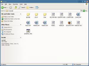

Remember, now... I used nLite as well as gosh's method... ;) Also, the winnt.sif file is working fine in the BOOT folder...
The BOOT folder has all the files necessary to partition the drive, etc. Also includes the setup file, txtsetup.sif...
The I386 folder has all the necessary XP files to be installed.
The rest of the files in the root of the CD are for my CD's menu, such as DELOAD.BIN, DISKEM1X.BIN, LOADER.BIN, and DISKEMU.CMD... The DAT files are Disk images... ;)
If you don't know how gosh's method works, I suggest you read his tutorial:
http://gosh.msfnhosting.com
See screeny:
