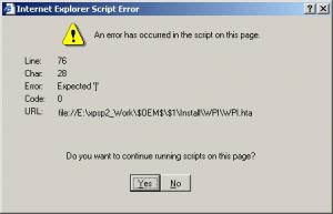

oioldman Posted May 18, 2005 Posted May 18, 2005 (edited) Hiya,have some small tweaking wih WPI to look and feel a bit more personal, whoever i've chaned something to cause a javascript error when it runs, but can't figure what change is causing it.The error is attached, (not sure how to add image) along wpi.hta, but as you can see the line 76 exist, but char28 doesn't or i'm think, which is likely.If I click yes or no it runs, but show none of the applications available, an dnone of the links for Options, Config etc workIf you need more, shout and will oblige, and any assistance appreciated.Apologies for the big post.an Oldman getting annoyededit: removed wpi.hta code as rather too big Edited May 18, 2005 by oioldman
Kelsenellenelvian Posted May 18, 2005 Posted May 18, 2005 WPI.hta is just the compiler your error is most likely in the wpiscripts that are compiled during start up. What changes have you made? Please post your config.js (Serials removed) and useroption.js. Also did you customize the theme at all?
oioldman Posted May 18, 2005 Author Posted May 18, 2005 @kelsenellenelvian - Thanks for your prompt and helpful reply as always.Ive done something simple and seems to have solved it!! copied from one dir to another, ran wpi.hta - all worked, so copied back again, replacing all files in process and all works.Shall burn to cd, and build to see what heppens.Will let you know out come.I did change the theme, by adding a different background and removing all reference to the tables and directing to the background image from within the wpi.htm body section with background= That fails in test as expected as runnig from different location.if of help, can still post my config.js and others if neeeded.Oldman

oioldman Posted May 19, 2005 Author Posted May 19, 2005 Thought a copy and re-copy would solve it, but when happened again, thought something else has to be an issue, though which file i'm not as only updated the config.js to add a cmd line to do a start /wait when installing a program as doesn't always work correctly, though if do standalone with same switch works fine!!If seeing the config.js helps shout and i'll post up as requested.Oldman
oioldman Posted May 20, 2005 Author Posted May 20, 2005 Update:having run and checked all settings, it appeared as though a line break had managed to make it's way into the config.js file. Added the command <br /> to create one, saved, tested and all ok.Thanks for pointing in right direction kelsenellenelvian
Kelsenellenelvian Posted May 20, 2005 Posted May 20, 2005 No prb m8 I have spent many an hour chasing little s*** like missing commas amd ; because this thing can get get really picky.
