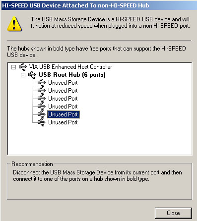

It seems that i can't install the usb 2.0 driver.
Whenever i install a usb device i get this warning
"this device can operate faster.. click for a list of faster ports"
but when i chlick it says "the hubs in bold are highspeed..." (see attached pic)
using other USB ports makes no difference, i keep getting the same thing

Also, the screenshot indicates that the device is USB 2 but not the USB ports themselves btw
