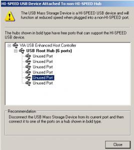

  1. thanks guys
  2. I'm running XP service park 2
  3. I was hoping someone could suggest a solution to my problem It seems that i can't install the usb 2.0 driver. Whenever i install a usb device i get this warning "this device can operate faster.. click for a list of faster ports" but when i chlick it says "the hubs in bold are highspeed..." (see attached pic) using other USB ports makes no difference, i keep getting the same thing I've tried updating the driver, but it says no newer drivers exist. driver date 1/06/2002 driver version 5.1.2600.0 if anyone could help i'd be really greatful!
