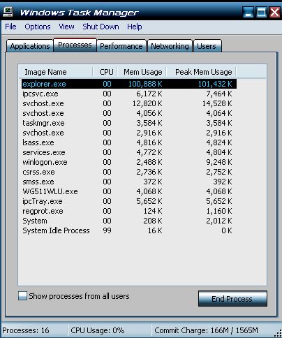

i have no idea why explorer.exe is usage such a large amount of memory. system is clean. xpsp2. only 2 programs run at startup. any ideas ?
Cashing, but I never get mine more then 21MB :}, I think you have a virus or something there...
Post your SERVICES.MSC list here and we could see if there is any thing in it that makes EXPLORER.EXE that big....

There is no strange service there as far as I can see, your explorer.exe should not get up to that 100MB. Realy, I think you have a virus there, or you used some strange reg tweaks?

Gave it more thought. Download filemon.exe from Sysinternals.com
After you run filemon.exe it will show you what resources explorer is accessing and causing it to use excessive resources. If explorer is using the suggested amount of resources, as you noted, filemon.exe will display those results (most of the time).
More then likely explorer is attempting to access a shortcut or program that you had deleted but the registry does not see that it has been removed and see's it as a valid entry.
Run a regcleaner to remove invalid registry keys.
  • Author
interesting thought...& i think u hit on something. although itz explorer, not Internet Explorer thatz the trouble, i am almost certain that installing internet download manager+crack is what screwed things up - it makes some pretty extensive changes to things. anyway, i restored from a ghost image. all is aok now
