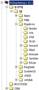

Mekrel Posted February 15, 2005 Posted February 15, 2005 Please post your winnt.sif in code tags and also a screenshot of your folder setup using the tree view in explorer.
hplsbyufan Posted February 21, 2005 Author Posted February 21, 2005 (edited) Please post your winnt.sif in code tags and also a screenshot of your folder setup using the tree view in explorer.<{POST_SNAPBACK}>Sorry for the delay. BTW, I have now tested with only vid drivers, and they alone cause the lockup. All my other drivers work when the Vid driver folder is not referenced in winnt.sif. My winnt.sif:;SetupMgrTag[Data] AutoPartition=0 MsDosInitiated="0" UnattendedInstall="Yes"[Unattended] DriverSigningPolicy=Ignore UnattendMode=FullUnattended OemSkipEula=Yes OemPnPDriversPath=winnt\pnpdrvrs;winnt\pnpdrvrs\0mobo;winnt\pnpdrvrs\1nic;winnt\pnpdrvrs\3tvIn;winnt\pnpdrvrs\4sound;winnt\pnpdrvrs\5kbd;winnt\pnpdrvrs\6mouse;winnt\pnpdrvrs\7printer;winnt\pnpdrvrs\8scan; OemPreinstall=Yes TargetPath=\WinNT[GuiUnattended] AdminPassword=penelope AutoLogon=Yes AutoLogonCount=3 OEMSkipRegional=1 TimeZone=10 OemSkipWelcome=1[UserData] FullName="Brandon Stout" OrgName=FamilyHomeVCD.com ComputerName=Home ProductID=(Omitted)[FavoritesEx] Title1="myname.url" URL1="myurl"[Branding] BrandIEUsingUnattended=Yes[URL] Home_Page=http://www.mozilla.org/products/firefox/central.html Help_Page=http://www.mozilla.org/products/firefox/central.html Search_Page=http://www.google.com/[TapiLocation] CountryCode=1 Dialing=Tone AreaCode=801[GuiRunOnce] Command0=winnt\install.cmd[Identification] JoinWorkgroup=WORKGROUP[Networking] InstallDefaultComponents=YesScreenshot of folder tree: Edited February 21, 2005 by prathapml
Mekrel Posted February 22, 2005 Posted February 22, 2005 Hmmm but why are you listing the winnt bit in your drivers path?For instance this is my winnt.sif driver path:OemPnPDriversPath="drivers\000_GART;drivers\001_MemCtl;drivers\002_IDE;drivers\003_SMBus;drivers\004_AudioDrv;drivers\005_AudioUtl;drivers\008_Ethernet;drivers\008_Ethernet\PreNRM;drivers\009_graphics;drivers\010_monitor"and also the folder containing all the folder with the driver files in should be in $1 not $$.for instance my screenshot for the above code:
hplsbyufan Posted February 22, 2005 Author Posted February 22, 2005 Hi Mekrel,I put the drivers in $$ instead of $1 simply because I prefer not to have the drivers in a folder right on the %systemdrive% root. The reskit's .chm file says that the driver path will automatically put %systemdrive% in front of the path for the oem drivers, so I started with \winnt, which is where files placed in $$ end up.I can try moving the drivers to $1 and removing \winnt from my path, but since all my other drivers work this way I have not tried that.Should I try $1 anyway? Thank you again for your assistance.BTW, Gerry Hickman, in the microsoft.public.win2000.setup_deployment Forum believes the problem is related to an .inf file, but I have not found one yet - all paths seem fine.
