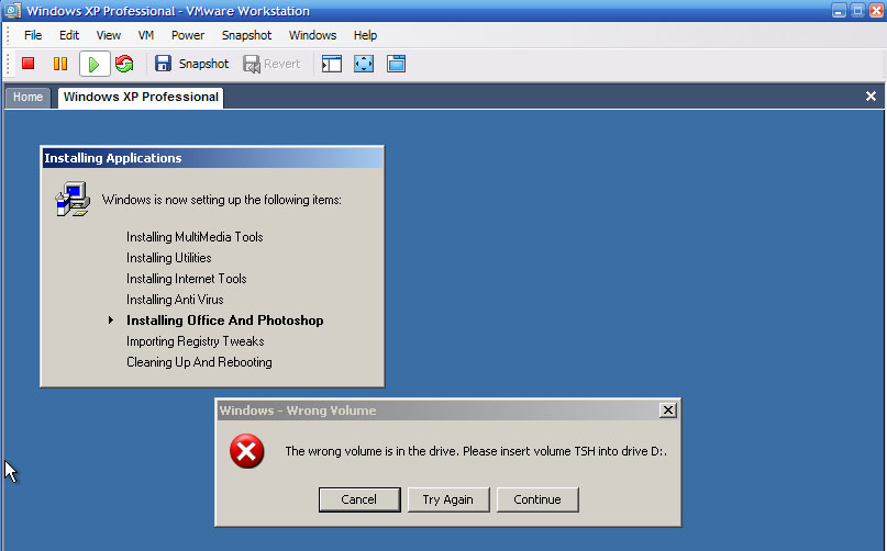

Wrong volume CDROM
  • Author
I am sorry
this is the Patch file code (but i make it a exe file)

so..
do it "Change The CD-ROM" !!!
Well what is the volume TSH?
Windows is done installing by now so it wouldnt be the windows cd right?
I'm pretty sure you're right about this, CHANDER. I suspect he has directly copied an installer of some kind that checks to make sure it is being installed from a CD and that TSH refers to the original CD of that particular program.
asbsamsf is also right though. The posted image that we were asked to troubleshoot is not related to the code that got posted.

all the Program are installed fine
but my problem is
when the photoshop installing is done the message come out
Astalavista

I am sorry.
CHANDER
TSH is the cd volume label
