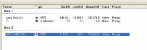

joeyg2391 Posted December 27, 2004 Author Posted December 27, 2004 Partion Magic reads it fine. I attched a pic to see partion magic settings. It's Disk 2

joeyg2391 Posted December 27, 2004 Author Posted December 27, 2004 Does anything look weird in my partion magic table
