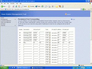

Guest Posted October 9, 2002 Posted October 9, 2002 My Microsoft Wireless networking base, is also a wireless router.My port forwarding works...Here is what yours should look like, well, at least the fTp linePrivate IP= Your network address IP (ex: 192.168.0.1)----------------------------------------------------------------------
