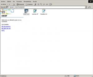

Hi Astalavista,
I followed prathapml + yrmethod = 13.735 MB (compressed as Good).
Here the comment I got (see the attached image)
;The comment below contains SFX script commands
Path=C:\Program Files\Executive Software\Diskeeper
Setup=diskeeper.msi /QNB
TempMode
Silent=1
Overwrite=1
1) Is my SFX comment/config correct since I set the Absolute Path + TempMode???
2 ) Is my RunOnceEx.cmd comman (see bellow) correct???
