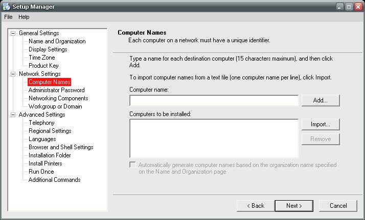

All you have to do is to Add those lines into your unattended file:
[userData]
ComputerName=*
[setupMgr]
ComputerName0=Alpha
ComputerName1=Bravo
ComputerName2=Charlie
ComputerName3=Delta
ComputerName4=Echo
-M

and on which point of setup you choose the desired name?

He don't wanna chooseit ! Anyways I recommand to use setupmgr.exe From your original XP Cd [CD:\SUPPORT\TOOLS\DEPLOY.CAB] There's a place to do is easylly.
