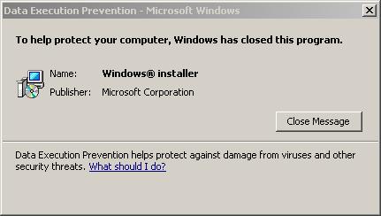

thuun derboy Posted October 10, 2005 Posted October 10, 2005 (edited) gave batch file a whirl...didn't work...same old forking problem, anyone else receive such trouble? (see image 2)also getting bloody data execution shutdown message at end of ANY install with Audition 1.5. which may or may not be issue if added to windows setup (usin' xp right now).Adobe just purchased this from the original coders_____ MR. BIG BUKSpost solution if found, no auto it please....THX! Edited October 10, 2005 by thuun derboy
homeskillet Posted October 13, 2005 Posted October 13, 2005 (edited) You have to shut off DEP before installing (I believe). There was a big discussion about it on the Adobe Audition ForumWhen you go to the link, click on "Log in as a Guest" to see the topic discussion. Read messages 5 - 13.Check it out, it may help you decide if you need to shut off DEP temporarily to get this bugger installed.Homeskillet Edited October 13, 2005 by homeskillet
Elph Posted October 14, 2005 Posted October 14, 2005 I messed with this for awhile, finally got a silent install to work.What I did was the following:1) I use AdminStudio, so I did a multistep snapshot. took the inital snapshot.2) Installed Audition 1.5 all the way thru3) Took the second snapshot.Once that was done, I ran it thru the repackager to get the MSI. If you do nothing else, you'll get the DEP that everyone else was encountering and the program wont run. To get around this:1) Exported the following from the machine I installed Audition on:HKEY_LOCAL_MACHINE\SOFTWARE\Microsoft\Windows\CurrentVersion\Uninstall\{86EF9FC4-F209-4520-B7E1-C7FF0EEBDFFF}2) using AdminStudio's Editor, I added that the to the MSI that I had created.From there, I distributed it to the machines I needed thru SMS. I made sure to have SMS reboot after the program was done installed. After it rebooted I was able to run the program fine.Hope this helps.
thuun derboy Posted October 16, 2005 Posted October 16, 2005 (edited) just gave this ONE more shot before altering original MSI...stupid adobe! what the @$#!?&%?!made sure to reboot...nada, same error..."unknown"guess it's time to break out a repacker, though,SOMEONE must have a simple solution somewhere._anybody?!thx. Edited October 16, 2005 by thuun derboy
