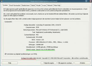

esp Posted September 29, 2004 Posted September 29, 2004 Hello,I slipstreamed SP2 manually into win xp prof.Later when using this cd to install a different pc I noticed directx 5 was still in place.I thought that directx 9.0c came with SP2?Anyway, checked with dxdiag and the first item that appears is ddraw.dll with version 5.03.2600.2180, so that is directx 5.At first I thougt I made a mistake somewhere but when i tried to install directx 9.0c redistributable the setup actually skips the installation part (the part where u see the progress bar) and ends immediatly at the last page saying "The components installed are now ready for use" but it actually have not been installed, when i enter dxdiag.exe its still DX5.Websetup doesn't help either, all the installers just finfish witin 2 seconds stating "The components installed are now ready for use" as if everything is fine.What am I miussing here?
Tsunami Posted September 29, 2004 Posted September 29, 2004 I have DirectX 9.0c installed, and when I open up DxDiag, it says that my DirectX version is 9.0c (4.09.0000.0904), and that my DxDiag version is 5.03.2600.2180. I think you're mixing those two. You're right that none of the files show a version of 9.0, most of them are 5.03.
Alanoll Posted September 29, 2004 Posted September 29, 2004 Wow....DX5....that's going back to the days of Windows 98. XP came with 8 to start with. I think Tsunami is right.
RyanVM Posted September 29, 2004 Posted September 29, 2004 The 5 at the beginning has NOTHING to do with the DirectX revision
prathapml Posted September 29, 2004 Posted September 29, 2004 yes that's right.The versioning DOES drive you up the the wall before you understand it. Think of it to be one of the down-sides about MS.esp, Go and sleep peacefully - DirectX 5 hasn't somehow made it to your XPSP2.
esp Posted September 29, 2004 Author Posted September 29, 2004 yup, indeed.I'll tell you how it got this far.Picture this;_ installing 2 pc's at the same time, both with seperate problems. Pc1 won't install network card untill I found out that it ONLY installs with the specific driver on a diskette. It so happens I'm in the middle of a renovation and I don't know where that one has gone. Went to the local pc shop to get a copy. NEVER buy a sweex network card.pc2 didn't wanna install sound drivers for some reason, resolved that fairly quickly. Other problems emerging with drivers not being compatible with SP2. Finally I was up to my third install to get my unattended SP2 cd perfectly right (on pc2 'caus pc1 was ok) untill I noticed a program called 'All to Wave' had a problem with directX 8 not being installed. I thought that was a bit weird and I took a look at dxdiag; completely overlooked what Tsunami pointed out in his screenshot. Never get angry with a pc... mmh I was ready to smash the thing, believe you me. Maybe an empty stumach had anything to do with it... I really thought that somehow SP2 f*ked up by not installing DX9.0c. If I didn't posted the problem here it probably would have taken me some more time.Thanks,grtz,esp
