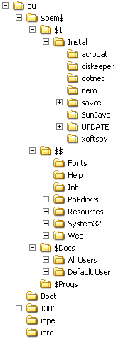

Or since you already have a multiboot, the simplest thing to do, would be to have each boot folder point to a different Install folder (I'm assuming you have boot folders). Then that negates any hardcoding, and each Install folder can have it's own CMDLINES.TXT.
  • Author
Alan - thanks for your thoughts and Ideas - have thought about this approach, however i would not prefer to use this as i would have to duplicate all my $oem$ installs etc see folder structure below.
