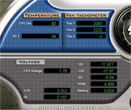

premier69 Posted August 7, 2004 Author Posted August 7, 2004 This is more detailed info on the current health of the system.btw, i thought this might be a tad too high but i guess not, anyways the question still remains, why cant i choose clock speed?and oh, i cant go below 10 in the multiplier or the computer wont boot.
Bâshrat the Sneaky Posted August 7, 2004 Posted August 7, 2004 Is that temp with a full stressed cpu?It's up to you to decide if it's okay for you that your cpu haets up to about 60°C or higher. Most people don't want it gets hotter than 50, with 55 absolute maximum. This does NOT mean the cpu can't stand this temp long... AMD recommends not to go above 85 degrees C...
