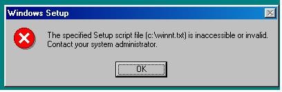

2. Issue is as stated while trying to utilize Gosh's downsize method, among other things, requiring I run the winnt32.exe with the /noreboot switch and the /unattend switch.
When I try this, I'm getting a message stating that the file is unvalid or inaccesable. I'll attach an image.
The exact syntax I'm using from the Run line (does the same thing whether WINXP or WIN98 running on VMWARE 4.0.1) is
winnt32.exe /dudisable /noreboot /unattend:c:\winnt.sif
where c:\winnt.sif is my unattended setup file. I've tried it with many different setup files, text files, etc. and always see the same thing.

Thank you for the assistance.
No change, though.
Specifying the /tempdrive:c: didn't appear to matter.
I still see the same error message.
It does change paths whenever I change the syntax on the /unattend switch, though.
e.g.
(running from CDROM, my D: drive)
D:\i386\winnt32.exe /dudisable /noreboot /unattend:\winnt.sif
gives me the error pictured in my 1st post but the path is changed to c:\windows\winnt32\winnt.sif

I've never tried to do an unattended install this way but looking at your original post, the error you received was, "The specified setup script file (C:\winnt.txt) is inaccesible or invalid.
It seems it's looking for a .txt file. Try making a copy of your winnt.sif and renaming it to winnt.txt, keeping both winnt.sif and winnt.txt in your I386 directory.
Who knows, maybe that will work.
